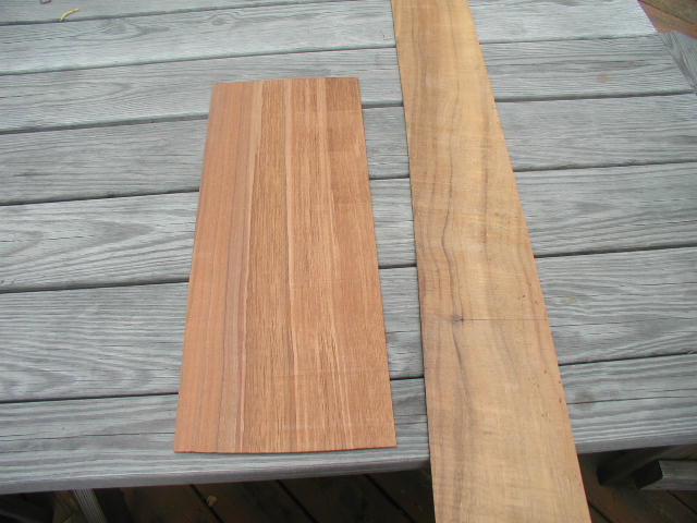

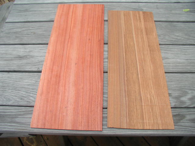

I'm interested in identifyikng the wood on the bottom in the first picture, also shown in the second picture. I'll let you know up front that this was identified as koa when I bought the board a number of years ago. The grain pattern and pore structure wouldn't lead me to believe otherwise, but I've just never seen another piece this red in color (and consequently can't find anything to make matching sides from.) A set of sides of more expected color is shown for contrast.
Can koa be this red? Anyone know a source for another board or sides of this color?

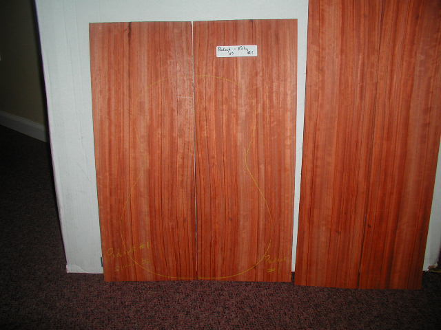

Padauk - hmmmm....   I have some padauk that I've been cutting recently (example below), and the color of the board in question when freshly sliced did not have the same red/orange intensity. My padauk doesn't have any of the darker lines in it either - can that happen or is the presence of the dark lines an indication that it isn't padauk? I'll look more closely at the grain and pores when I get home.

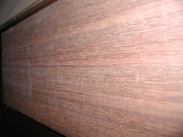

Sorry, wasn't feeling well last evening and didn't follow up on anyone's suggestions. hanks Charlie and Ronn. It's definitely nothing like Purpleheart. I'll try to chase the meranti suggestion. I don't think its Luan. I think the white in the pores is bad photography - I'll try to get some pictures in daylight when I get home today.

PostPosted: Tue Jun 12, 2007 3:08 am
I cant trust the colors on this monitor but the second picture looks like Mahogany in grain structure to me.

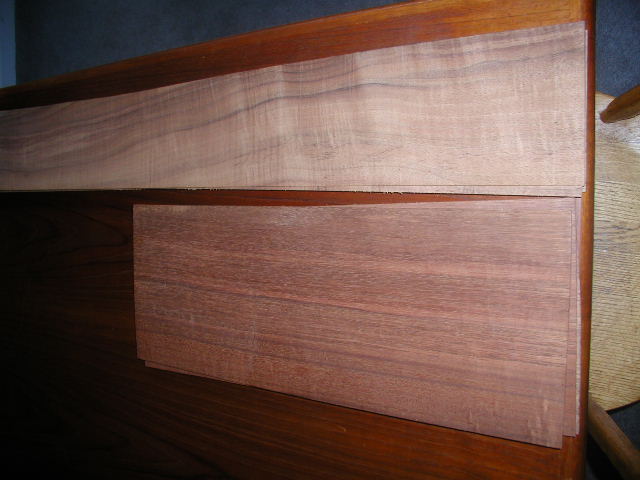

OK, here is another try, with pictures taken in very diffuse daylight (about the best we get this week )
The first picture shows the too-red ?koa? next to a koa side. This is probably a closer-to-truth version of the true colors than the first pictures above, where I think the sample in question is maybe too red due to the camera flash.
The next picture is the piece in question next to Padauk.
Everything here is freshly sanded. Any notion that the piece in question is "red" really takes a beating here.
(Looks less red than it does in the first picture, doesn't it??)
?? Whaddya think?? Could it be koa or do I still need to look elsewhere?
